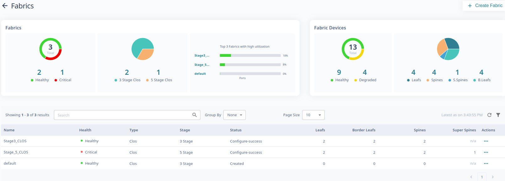

  1. In the Navigation menu, select Fabrics.
  2. In the Fabrics page, click anywhere in the required fabric row except the Actions column (Actions column icon) to proceed to the fabric Topology page.

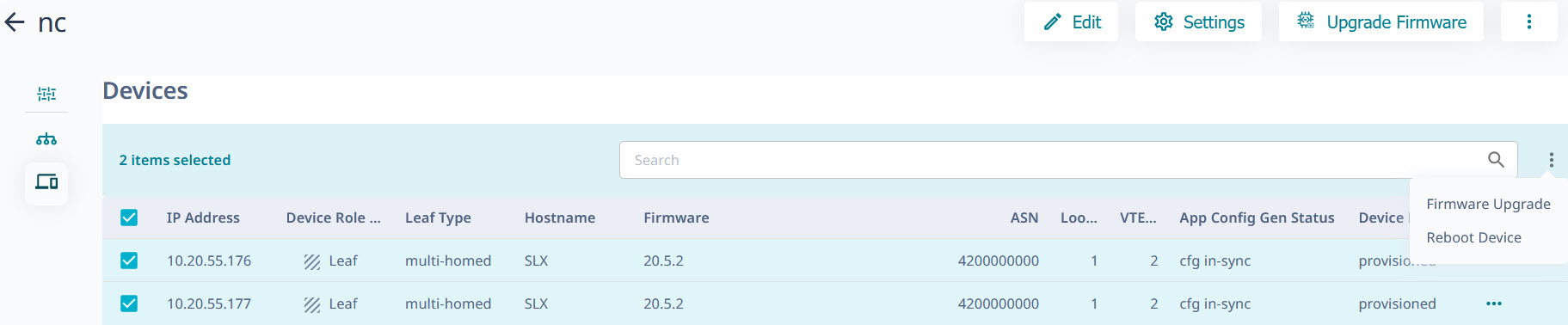

  3. Optional: To upgrade firmware of the selected devices in the fabric, do the following:
    1. In the Topology page, go to Device Management ( Device management icon ) to select the check boxes of the required devices.
    2. Select Firmware Upgrade from the Actions column (Actions column icon) for the device you want to upgrade.
      To upgrade firmware of multiple devices in the fabric, select Firmware Upgrade from the Devices table menu (device table menu icon).

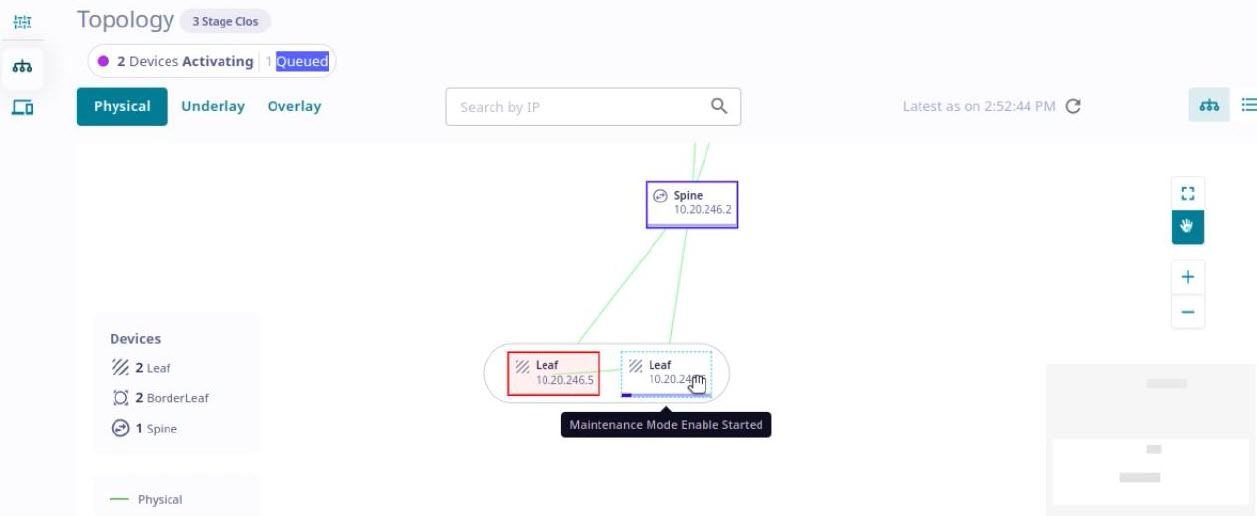

    • The list of devices in the fabric is displayed.
    • The LLDP links of the devices in the fabric might go down during firmware download as devices reload and will be in the maintenance mode. This is reflected in the fabric topology view as "No physical links discovered".

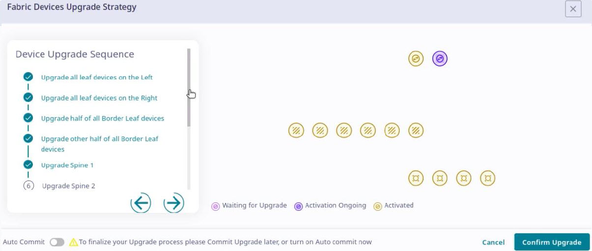

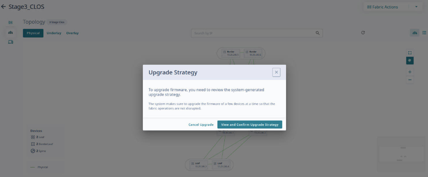

    • You are prompted to review the system generated upgrade strategy to minimize traffic disruption to the active fabric.
  10. Select View and Confirm Upgrade Strategy to review and approve the device upgrade sequence.
    View and Confirm Upgrade Strategy WindowFabric Devices Upgrade Sequence
  11. Select Confirm Upgrade.

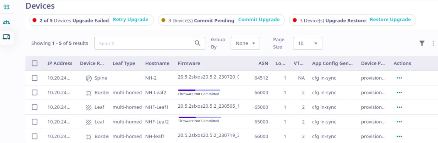

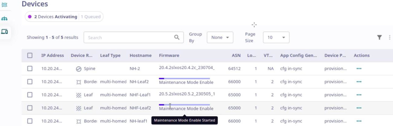

    • The list of devices in the fabric along with upgrade status is displayed.Fabric device upgrade status
    • The device upgrade status indicates various stages such as download, active, and commit. The user interface also provides updates such as the number of devices undergoing upgrade, waiting for upgrade, activation and commit pending, commit upgrade, restore upgrade, and upgrade success.
    • To change maintenance mode settings of a device, see Device Settings (Fabric Mode).
    Firmware upgrade status in the topology
  12. Select Commit Upgrade to commit pending devices.
    Commit status
    The devices are upgraded to the downloaded firmware version. Refresh the page to view the updated list.
